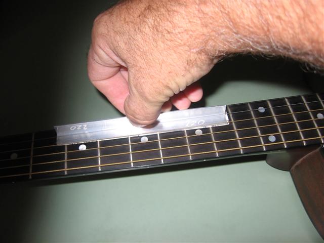

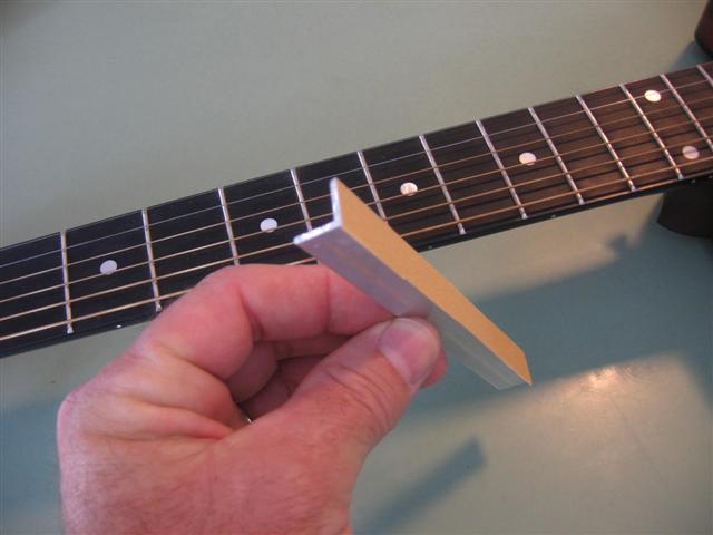

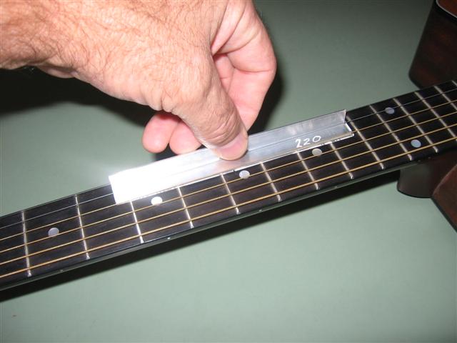

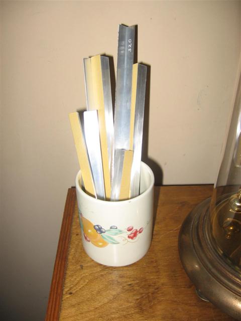

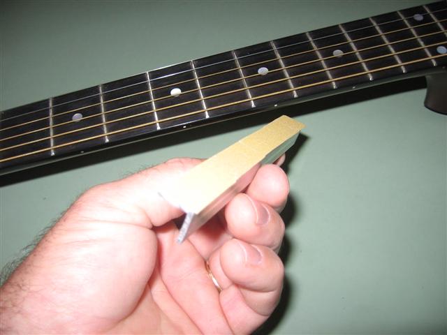

This is a coffee cup full of little aluminum fret levelers. It is such a simple tool, no one has put a picture up until now. I have one ten inch, one four inch, the rest are all 6 and 8 inches.
They slide under the string at tension to level the frets and progress through the grits to get 'em smooth. Evan and Rick had a couple threads going which talk about them. This is just a visual aid for slow learners like me.......
Just release the truss rod to flat then you begin your efforts to level sand the frets under full string tension. as Evan said: It's so fast it's scary. You may want to start out on an old junker before moving to your nice hand-builts.
Refer to the other two threads for details. I used some 6" Mirka sanding discs to get the grit I needed. Rick uses rolls to get the length needed.

I still don't get it. Why worry about the truss rod with such a short leveler?
PostPosted: Wed Aug 22, 2007 6:15 am
Posts: 4819
It makes sense that if you're trying to level, start with a level surface. It
takes a few seconds to adjust the rod, so why not?

Awesome Bruce, what depth cup do you use to hold these and do you think the material of the cup affects the tone?
How is that for over thinking?
Best, Evan

Hesh, you've got it. Use a straight edge along the fretboard to make sure
it's level before fretting.
I'm not sure I understand the question about seeing a description of the
entire procedure using the levelers. Do you mean using the levelers
themselves, or the steps you posted?
PostPosted: Wed Aug 22, 2007 12:57 pm
Hesh, I simply point you to the comment Rick made in the other thread. Just do it.
I think the reason no one ever posted pics is that they are almost self-explanatory.
Once I made them, it was a real let down to actually use them. All the mystery was gone! I can now level anyfret anywhere anyhow!
Couple this with my old Stanley #5 body wrapped in sandpaper to level fretboards before fretting and geeze, necks, fretboards and leveling is a breeze.
Matter of fact this is somewhat of the feeling I get when all the planets align. Oh my.

Evan, I don't think you or Bruce have thought this through. This is the only cup you should use to store the fret levelers in. It,s the proper depth and the material is guaranteed to improve the sound of anu guitar.
PostPosted: Thu Aug 23, 2007 2:47 am
Actually, I dug the cup in question out of the trash.
It was my favorite coffee cup.
No one told me it got broken, but the handle was missing.
And one more piece of trash in the bucket, it would have been gone forever. I would not have see it.
So, that cup has sentimental value and I will ease it down to the shop today to find it's place on my cluttered bench, along with the little turner fret levelers.
